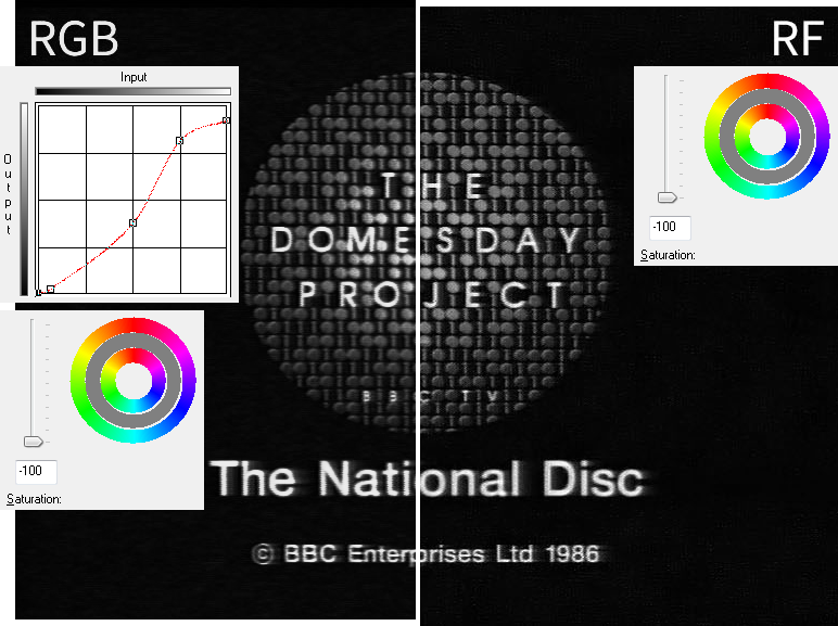

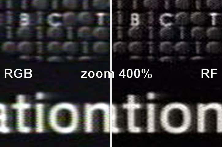

So red-laser is a definite plus. (Thanks.) Are the most recommended players also red-laser? Or are they so good without red-laser that they overshadow lesser players with red-laser?
@ spoRv - Thanks for the heads-up! I was hoping for something a little more sexy (a bronze babe would've been nice -- maybe poita has something ... with color). But, in the meantime, their B&W caps (with my split-screen and zoom) show . .
[Image: Domesday_RGB-_RF_compare.png]
[Image: Domesday_RGB-_RF_compare_zoom.png]

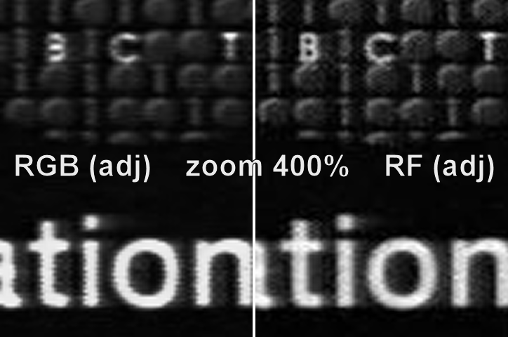

#40
Before we heap too much praise on this limited B&W capture, I thought to normalize the RGB capture (as we might normally do) and remove the tint from the RF capture (the eye-dropper knows all) . .
[Image: Domesday_RGB-_RF_compare_normalized.png]
RGB not looking quite so bad and RF's apparent "detail" looks like it might need to be de-noised. Of course, color pictures wouldn't be de-saturated as done on these B&W ones. So if anyone has any color comparisons, those would be good testing.
[added: the all-eyeing zoom]
[Image: Domesday_RGB-_RF_compare_normalized_zoom.png]
Of course, my quick adjustments needed zoom (too) for finer tuning, but you get the idea. RF resolves better horizontally (asee "B"), but still needs clean-up (see "ation"). BTW, these pictures were .JPG (lossy), meaning everything here is really rough. We could use better .PNG (lossless) screenshots to compare.
