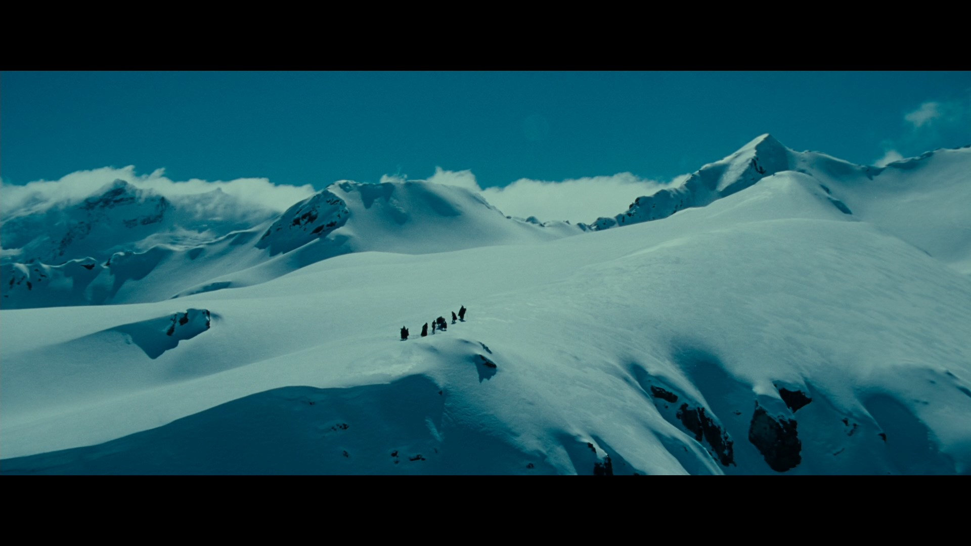

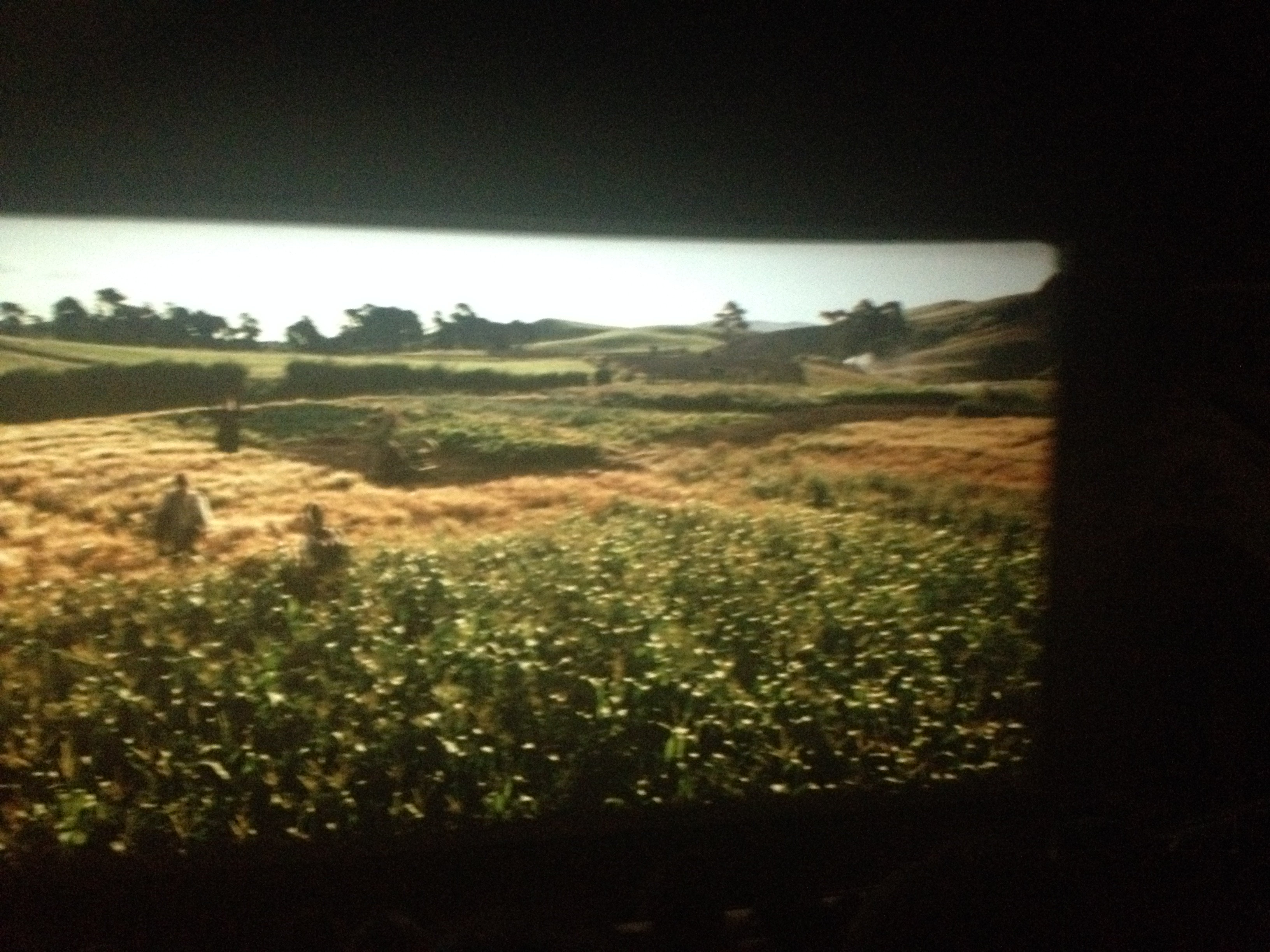

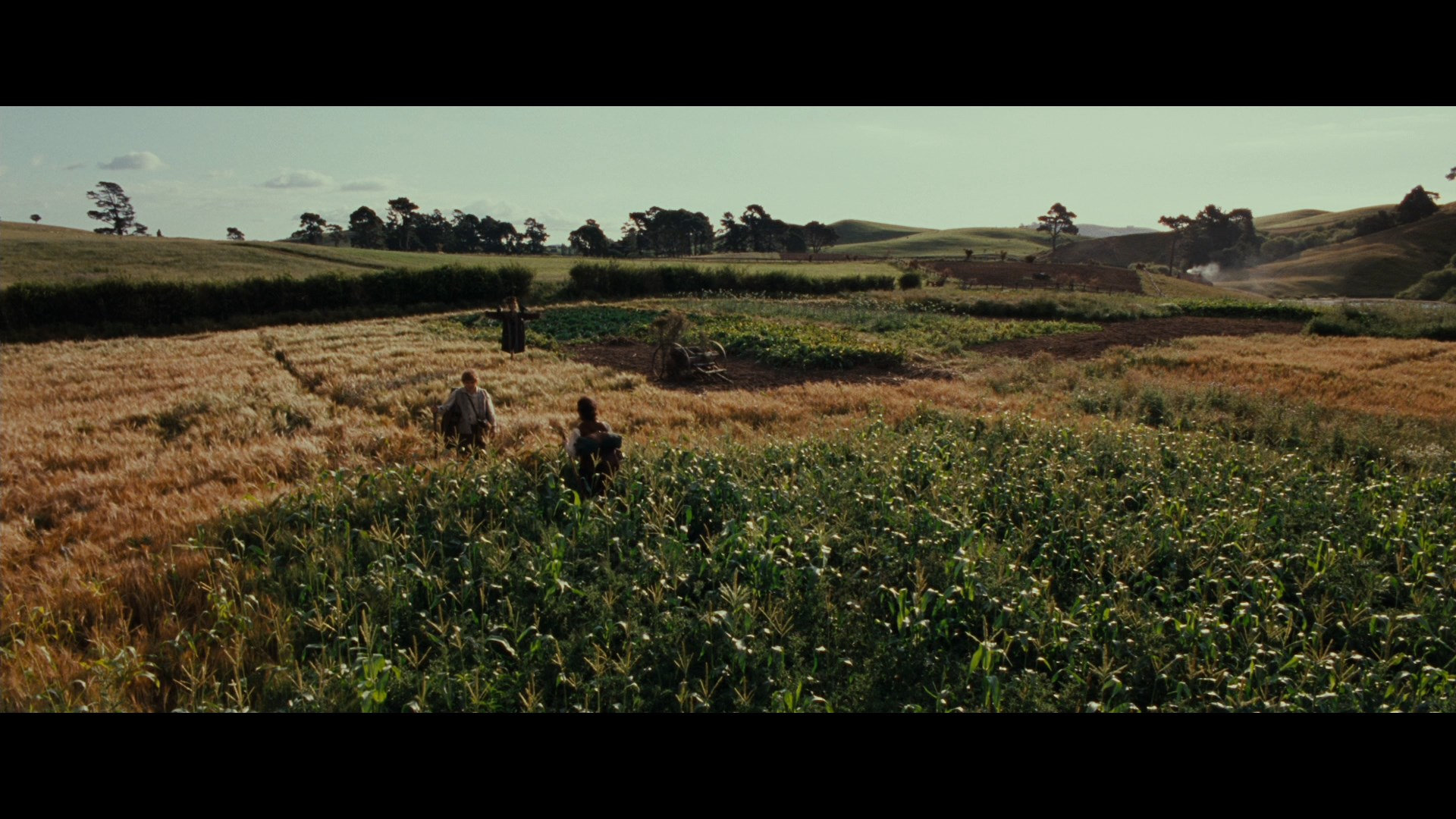

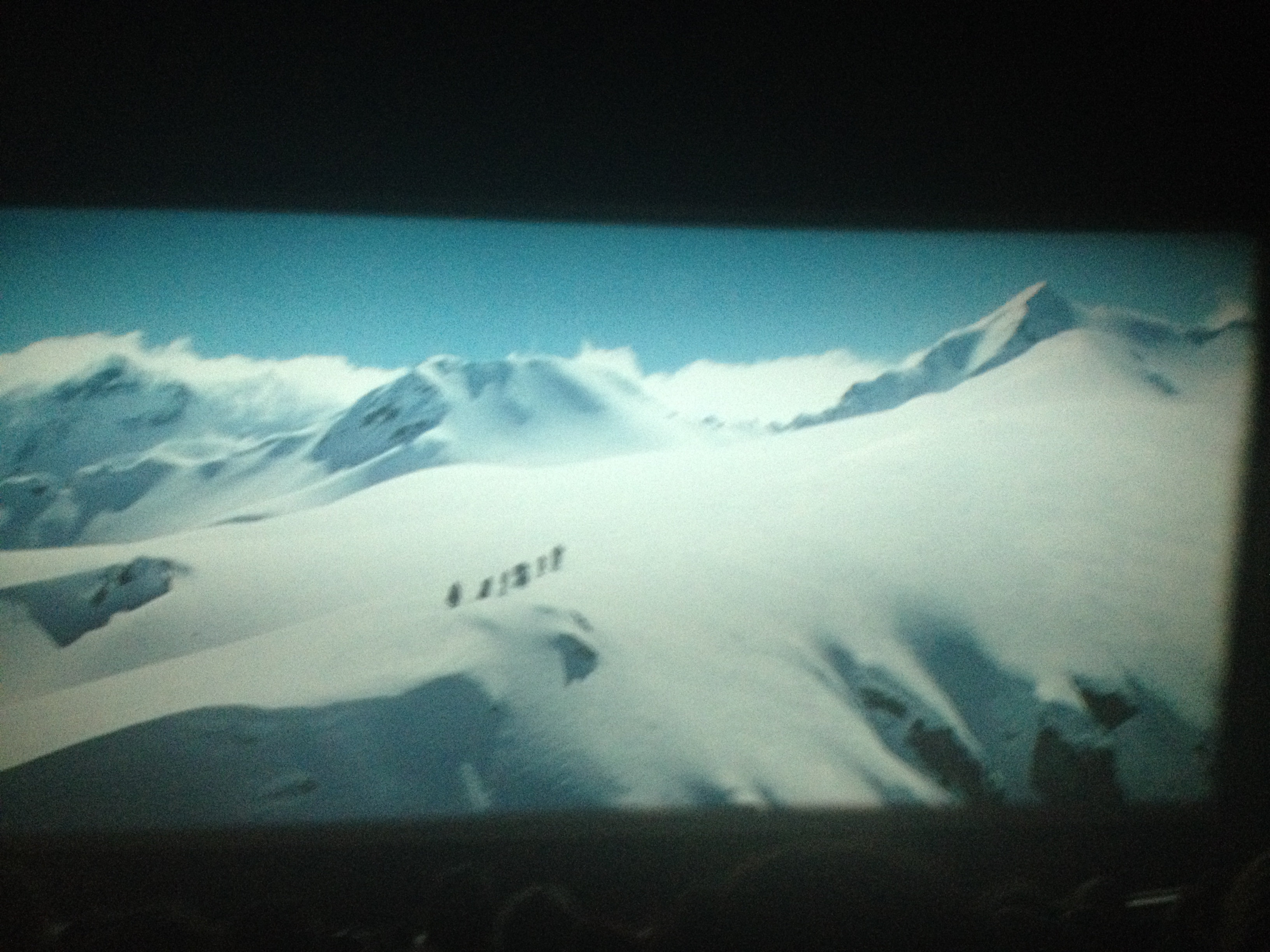

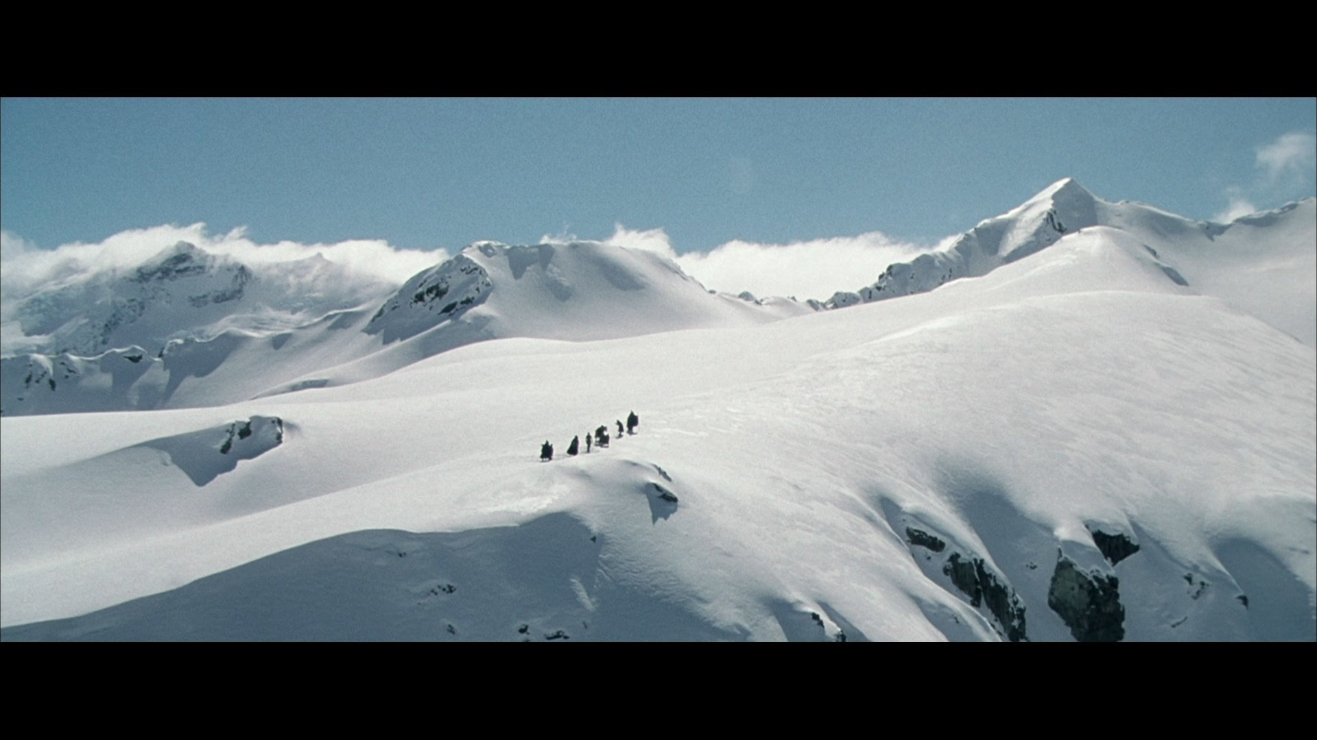

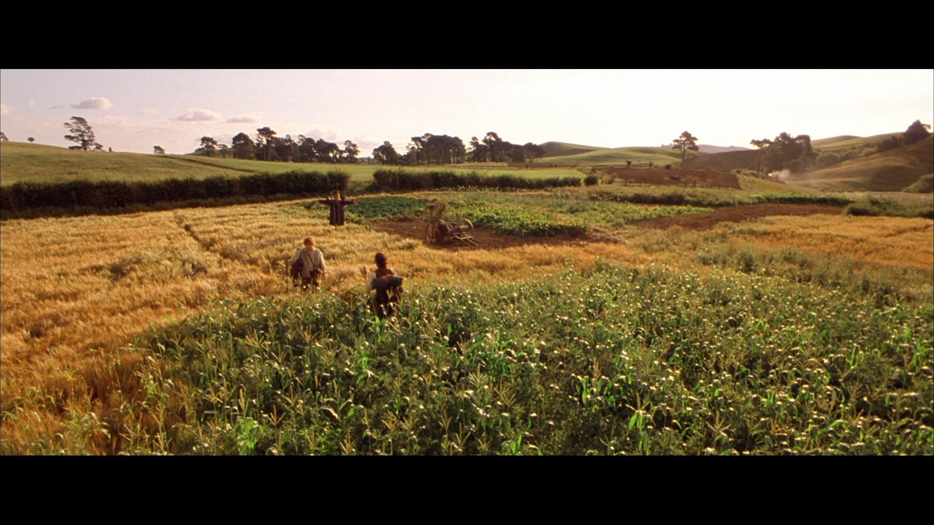

Actually, you should know that the Extended Blu-ray of Fellowhip is more faithfull colorwise to a 35mm print. It's oversaturated in its "greenness", though. And all 3 movies share the same color palette on 35mm.
Theatrical cut 35mm screening / Theatrical cut Blu-ray / Extended Blu-ray:

I don't believe that claim for one second. There's a huge difference between a color shift caused by the result of a Digital Intermediate going to print, and a completely regraded version of the film. In most instances, the Blu-ray doesn't even have the same grade applied that the film originally had in 2001. The entire grade was redone, and without any love or care. There are so many areas that are so incredibly sloppy. I can't believe you'd claim that it's just a color shift intended to match the 35mm. It's not. It's a botched grade. Check out this shot that comes to mind. Not only does it have the awful grade, but the colorist must have forgotten to track the power window. The mask that's supposed to be on Gandalf's face and hat is off into the sky.
[Image: 6JGV2HjlzAMk7M2-6OOe2bOovNfKitc1vWBSsIMe...9-h1448-no]
You may be right that the 35mm has a slight color shift. That's very common with prints, because normally the version on DVD and Blu-ray comes straight from the DI, not the print. But that doesn't justify a botched color job. If you'd like to restore the look of the film print, then you should research what stock was used, and then apply an emulation LUT of that film stock to my color restoration. Then it would actually look like the print.  Smile
