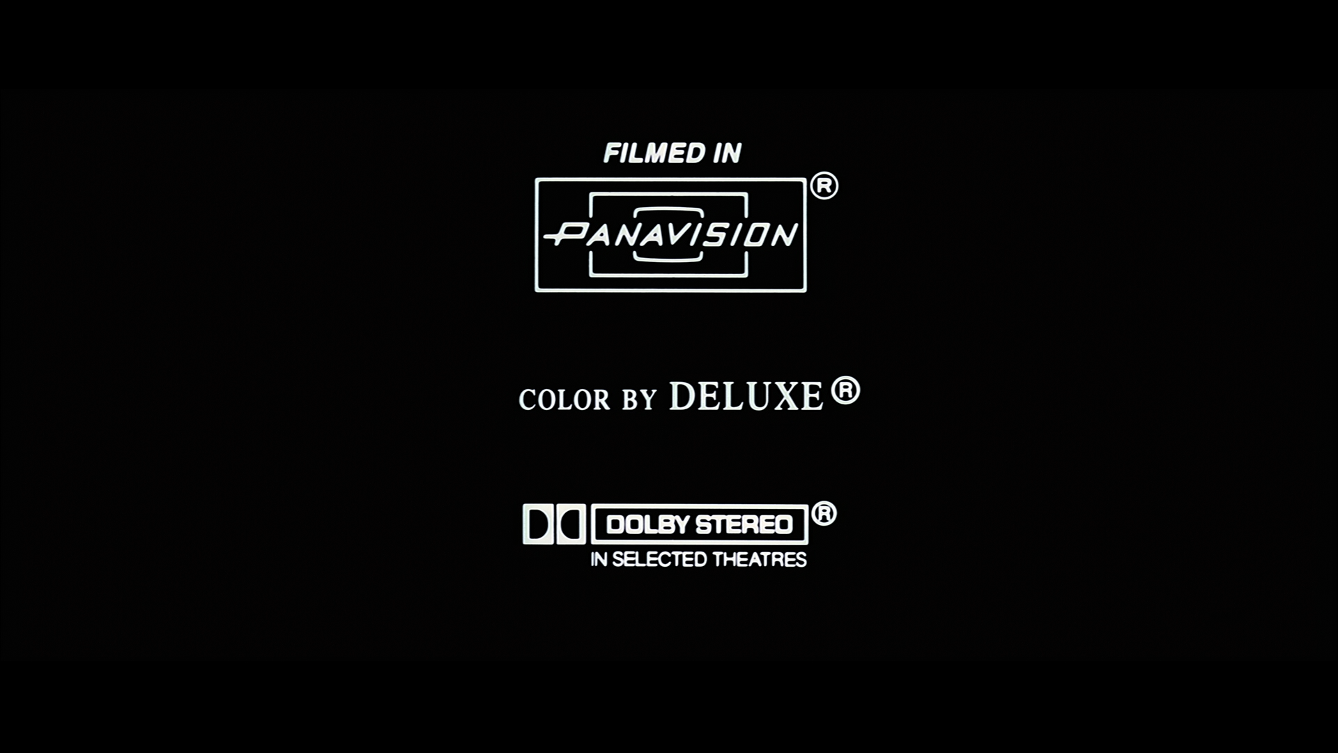

Well, no, not really. Because y'know how I said the first Dolby Digital film was Batman Returns? Well...
(skip to 1:23 or so if the timestamp doesn't work)
... yeah, it just uses the old "Dolby Stereo in selected theatres" logo. Same thing with MRS. DOUBTFIRE a year later in 1993:
[Image: mrsdoubtfire-specs.png]
IMDb doesn't help much here, by the way: it is extremely muddled and inconsistent with its terminology for films around this period. Sometimes it'll just say "Dolby", other times "Dolby SR", "Dolby SR-D", "Dolby Digital", or just "Dolby Stereo". But I'm reasonably sure that BATMAN RETURNS and MRS. DOUBTFIRE both had digital Dolby, so what gives?
It seems at first (circa 1992) the terms used were variously "Dolby Stereo Digital" and "Dolby SR-D" rather than "Dolby Digital" (e.g. see here), then in 1995 they hit a transition period which seems like it must've started with this absolute branding nightmare mess shown above and eventually settled at some point on just "Dolby Digital".
So what does this mean from a preservation standpoint then?
I'm assuming that films like BATMAN RETURNS, MRS. DOUBTFIRE, A GOOFY MOVIE, TOY STORY, and hundreds of others all had two mixes that appeared on all of their 35 mm prints: the "legacy" Dolby Stereo 4:2 matrixed audio on the analogue optical tracks so that the vast majority of theatres could play that back, plus a fancy new 320 kbps Dolby Stereo Digital / Dolby SR-D / Dolby Digital track with 6 discrete channels (essentially the first time they were able to store the equivalent of a 70 mm mix on the limited space available on a 35 mm print) for theatres who upgraded to digital decoders. If I'm correct about that, then it's probably very much a question of personal taste and subjective opinion whether either the 4:2 matrixed Dolby Stereo or the 6-track (5.1) Dolby Digital audio is truly the "original" mix. Who's to say which, if either, was given the most attention / prioritised during production? I wouldn't be at all surprised if I were to find out that some studios would have seen the Dolby Digital as less important due to Dolby Stereo being more established (and therefore more likely to be what theatres would be capable of playing back when the new digital format first launched) whereas conversely some others might have been more interested in innovating with the newly available 6-track digital format, so it might well be that some films will have significantly better Dolby Stereo mixes and others will have more impressive Dolby Digital presentations. But that's speculation based on my impression of things and looking at how the original "Dolby system" was seen back in the mono era before STAR WARS catapulted it to ubiquity (mostly by accident, it would seem). One might think that in general a discrete multi-channel mix would be subjectively preferable to a 2-channel or mono track in the vast majority of cases, but that may not necessarily be true in practice.
EDIT: Part of what makes me doubt this somewhat is that I'm not 100% convinced that every film had discrete 6-channel mixes, even when using the "Digital" logo. The one I showed at the top of this post is from A GOOFY MOVIE, which as far as I'm aware has never had a discrete 5.1 mix on home video. The UK DVD *claims* to have a 5.1 Dolby Digital AC-3 track but it doesn't; the LaserDisc didn't either (just 4:2 matrixed PCM "Dolby Surround"); the Blu-ray just recycles a version of the 2.0 track off the DVD as well, with some adjustments for sync changes etc.
