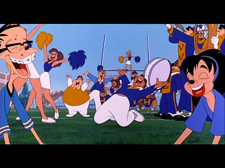

Of the above four now-censored scenes, the only one that even slightly raises an eyebrow for me is that second one, wherein the protagonist Max reacts with intense excitement to having a positive interaction with the girl he likes and then proceeds to dance around the room with a seemingly amused school secretary... but in the theatrical/LD/DVD version, as you can see from the above, he's not particularly self-aware of where he's putting his hands. I can definitely see that being interpreted as problematic, if noticed at all, although honestly it's only ever for maybe 1-3 frames at a time that you'd see the offending hand positioning so it's not exactly something that jumps out at you unless you're navigating frame by frame or specifically looking for it. The others are innocuous and in some cases fairly hilarious imo, particularly that first one (which would only conceivably be an issue if it was more than a few frames of contact and/or wasn't in what is very clearly coded as a clichéd dream sequence in the mind of a pubescent teenage boy). But that's not even really the point: the point is that it's been changed and is now no longer the original cut of the film for that reason. And as you'll know from my constant banging on about it with STAR WARS and THE EXORCIST and all those other films that have been messed with, I'm not OK with that.

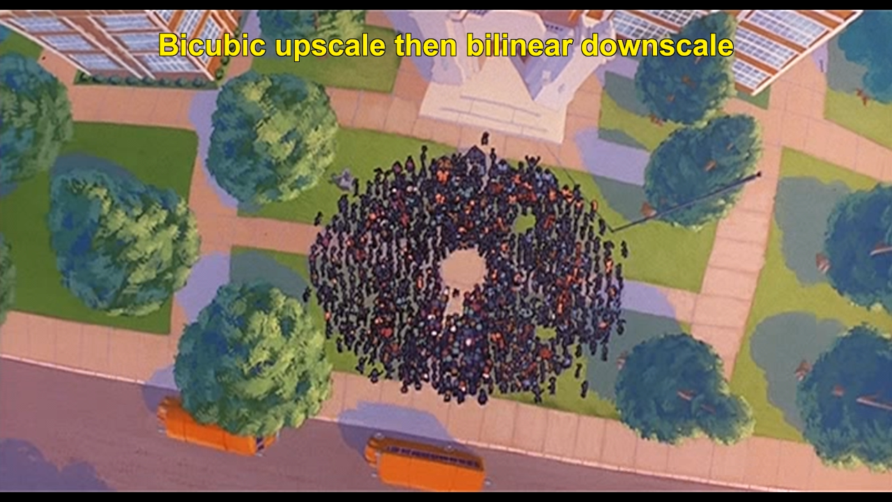

But getting the noisy 2001 DVD encode to look decent in 720p is a bit trickier. I could theoretically just leave it as 720 x 576, but I'd have to re-encode it anyway regardless because of the edits to the video, and I'd also have to either use non-square storage ratio (e.g. by setting "-sar 59:54" in the encoder) or rescale it anyway to get square pixels at 768 x 576, and I figure if I'm going to be doing those things then the quality is probably going to suffer *more* than if I just go ahead and upscale it (because at least if I up-and-then-downscale I can do things like antialiasing to try to improve it at least a tiny bit).
I'm messing about with different upscaling methods like I did on THE EXORCIST and I think I'm probably going to just keep using the same basic methodology that I used on that one for this as well. I tested out some specialised upscaling filters/scripts like SuperRes and so forth but they all resulted in an overly sharp image that just accentuated the already heavy grain, video noise, edge enhancement ringing/haloing and video compression artefacts that were in the original DVD encode. The way I did THE EXORCIST looked... well, fine, but certainly not mindblowing. It's softer by design than most of the rescaling filters people seem to commonly recommend, because I honestly feel like it looks better that way due to all the noise/artefacts in the original source. Still, it's highly subjective, and often the differences between one method and another are so minute that I can't really decide definitively which looks best. What I did for THE EXORCIST was a bicubic upscale (4x) followed by a bilinear downscale to the target resolution; I did that initially on this as well, but I figured maybe it's also worth giving a spline method a bash to see how it looks. It is indeed sharper, which is why I didn't use it before, but I don't know if it necessarily looks bad and in some ways the little bit of extra sharpness arguably helps with the hard outlines of the animation.
Here's how it looks after the "Exorcist method" of bicubic upscale then bilinear downscale. Obviously this has also been compressed by Vimeo so it will probably look a bit worse than it would if you were looking at an x264 encode directly on my machine (same pw again):
Finally, a couple of particularly noisy/artefacty comparisons between bicubic-then-bilinear and bicubic-then-spline36 scaling so you can see how small a difference it is, but nonetheless that the spline scaler does give a sharper image (for better or worse):
