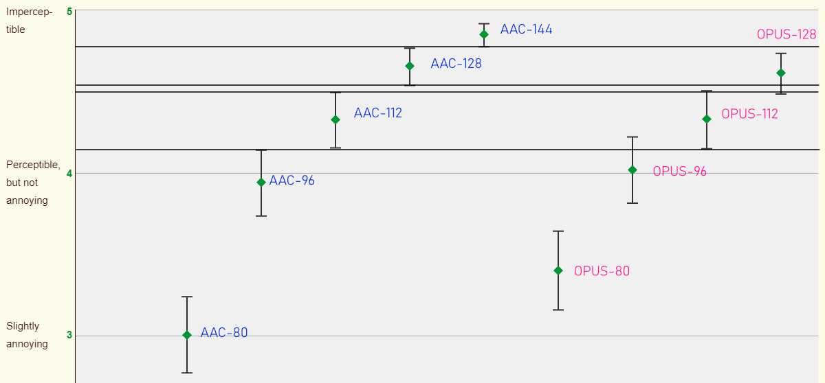

(2020-12-09, 08:59 PM)spoRv Wrote: I tested - briefly, I must admit - several codecs, and the one that astonished me more is Opus; even at low bitrate, quality is relatively high; AAC is quite good, but Vorbis is better; MP3 is the worst; still, to get the best quality/filesize ratio, I'd not go lower than 4:1 compression with any lossy codec, while I'll never use lossy for archival purpose.
Opus was made for low latency , as such, @ 128kps, AAC may beat it. As such, I recommend AAC & vorbis over Opus, except at extremely low rates (<50kps/chan)
