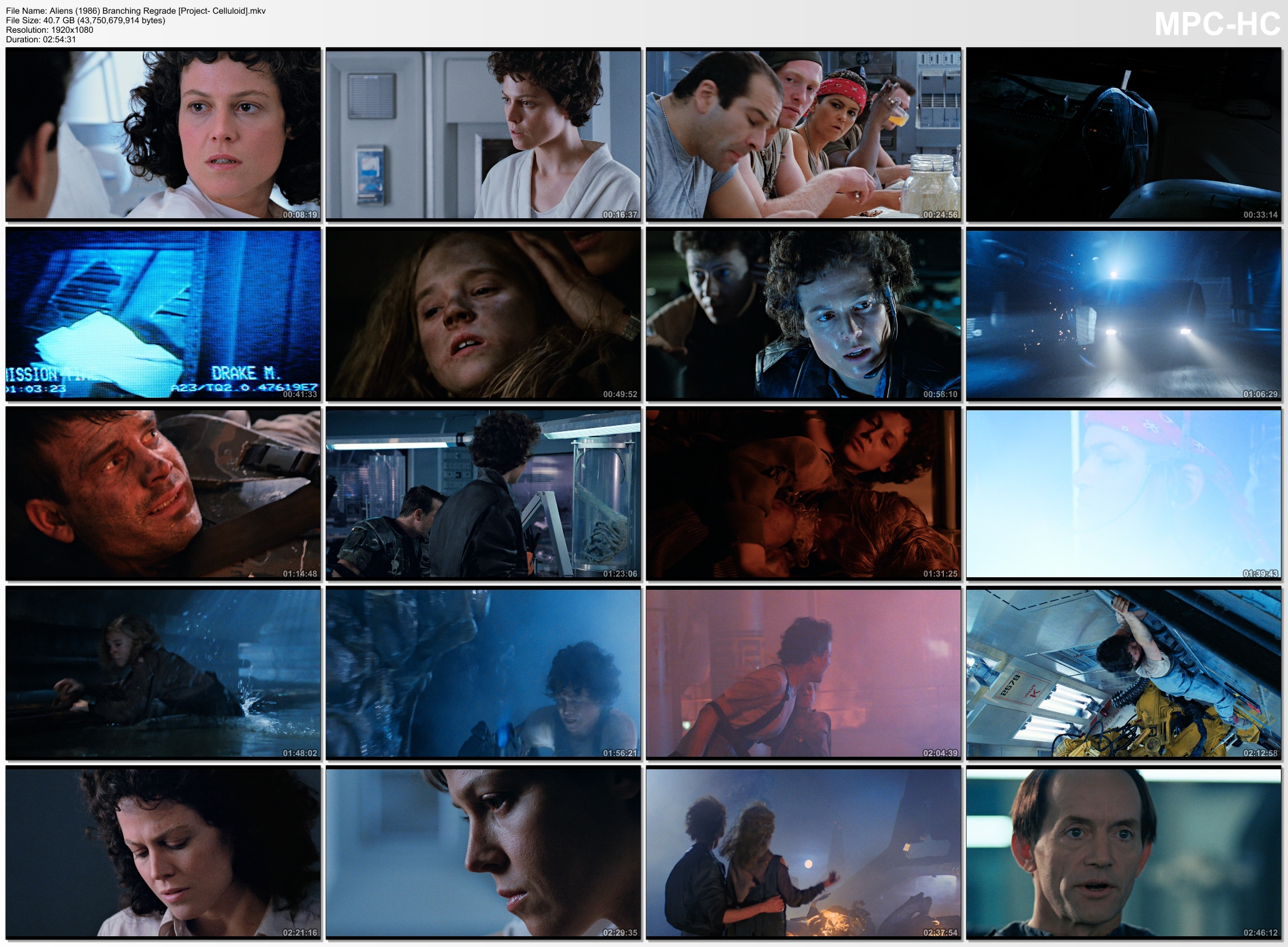

So with that said, I present to you all the "seamlessly branching" Project: Celluloid blanket regrade of Aliens!
[Image: Aliens-1986-Branching-Regrade-Project-Ce...-00-59.jpg]
The regrade itself is fairly simple in principle: A Dr. Dre generated LUT that was then further adjusted in Resolve to properly set a clean white point (no highlights should be clipped—though the image as a whole will appear brighter as a result of the grade which may make some of the master's baked clipping more noticeable) and then applied to all of the available footage from the Anthology Blu-ray master of both Theatrical and Special Edition.

As a whole saturation has been pushed harder—with blues especially taking on a rich cyan tone now rather than the dull teals of the BD—with color separation also being generally improved as a result. It's a bit quirky in areas but I think it's generally a massive improvement for the most part.
Furthermore the regrade was rendered in Rec.2020 and then converted to xvYCC via AviSynth in an attempt to help contain some of the more extreme colors tints within some sort of wider gamut / color space. I have no way to tell if it exactly works admittedly, but given it displays Rec.709 fine for the most part (with slight color shifting in the reds being the most notable byproduct of the process) I just decided to take a leap of faith given hardly anyone's encoding their projects with that particular transfer characteristic in mind and wanted to see what happens.

Congratulations on the finished project!
(2022-08-21, 04:50 PM)applesandrice Wrote: Congratulations on the finished project!
Agreed, looks like a real winner!
Love that the TV cut was included.

From what I tested it seemed to work just fine in kodi, at least for theatrical and special edition. I couldn't get it to play the TV cut at all, it just stopped after the credits of the SE. I didn't sit down and watch the whole thing straight through yet to test if there was any noticeable frame-skipping. MPV worked just fine. I see why ordered chapters aren't used very much, it's a pretty clunky setup.
But otherwise I really like how this looks! Much nicer then the colors on the blu-ray IMHO.
Haven't gotten a chance to comment, this is an EXPERT regrade, very much meticulously done with DrDre's matching tool. The care to really line it up with a 35mm reference shows.
